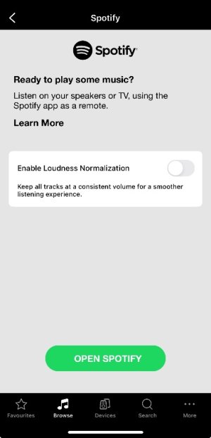

Hi all,
I tried to access Spotify via de Wiim home app, like I often do with Tidal. However, I get a Spotify screen that simply refers to the Spotify app. Is this a new feature or is ghere something wrong with my Wiim home app?
Thanks!

What you are seeing is normal for Spotify, as it is controlled via the Spotify app, and not by the WiiM Home app.
