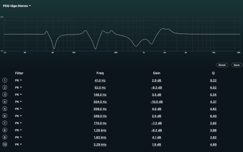

How does the PEQ filter table look? The sub could be too loud and overpowering everything else.
See attached. I have the sub on real low volym so that doesnt interfere with what im hearing. Could be that my mids produces sound at 60hz and the sub is just very low. I feel that they have to take a look the sub out.

How did you do this RC run? Was this with the sub enabled in the WiiM Home App or disabled? What crossover frequency (if applicable)? Which settings for RC (target curve, frequency range, max. gain, max Q)? The result clearly shows correction between 40 Hz and ~3 kHz.
If anything is not working satisfactory right now it's RC, not the sub out configuration.
Ran it with sub disabled in the wiim app. Now im at 60 hz crossover. My speakers: 33 - 40.000 Hz +/- 3dB (in-room) (Buchardt s400 mk 2). If i go over 60hz i can clearly hear the mids on my speakers disappear so i guess i just have to very low on the crossover.

You might try limiting the RC frequency range to 40hz-400hz. Also please try changing the phase of the subwoofer to find a better sounding setting.

Normally you would need to run RC with the subwoofer on. Currently, the correction only occurs at frequencies above the crossover.
The PEQ screen you originally posted shows a negative adjustment in the 400Hz-2kHz range. If this is the cause, limiting the frequency range to 40hz-400hz may bring back the midrange.
However, it is also possible that the sound you were hearing before RC had too much emphasis on the midrange. If you install a measurement application on your phone and take a sweep measurement, it will reveal the cause to some extent.

If you still have the PEQ you originally posted, you can listen to it with bands 7 and 8 off.
Cool. Turn it off. But cant save it. They return to PK for some reason as soon as i press save. Might be a bug.
Save it to a name other than "Auto". Use a name that does not contain that string at all.
