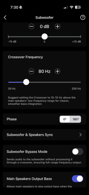

He all, I’ve got an RSL Speedwoofer connected to the sub-out on my Wiim. I’ve got the crossover in Wiim settings set to 80hz.
If I’m watching tv at lower volumes the sub doesn’t turn on. Even if I turn the volume up some, if I’m just watching something that’s mostly dialog, etc, the sub doesn’t turn on.
If I manually turn the sub on then flip the switch back to auto-on it will stay on, but won’t turn itself on in auto-on mode. It’s like there isn’t enough signal or the nothing is being passed to the sub below 80hz to trigger it to turn on.
Is this normal? Any ideas for a fix? Thanks!
Welcome.
What are your other settings in the subwoofer screen?
What about the subwoofer dials themselves? e.g. I'm assuming the sub itself has a crossover setting.
Hello, thanks for the reply. See photo for sub settings in app. Crossover knob on the sub is set around 100hz, but I figure it’s not getting any signal above 80hz from the Wiim anyway…. IMG_3780.png
