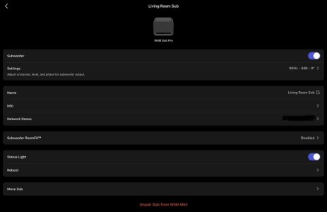

When I connect the WiiM Sub Pro wirelessly to a Wiim device, whether that be a Mini or an Ultra, I just get these options:

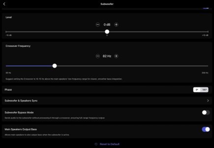

It’s only when I choose Wired that the Subwoofer&Speakers Sync, Subwoofer Bypass Mode and Main Speakers Output Bass options appear.

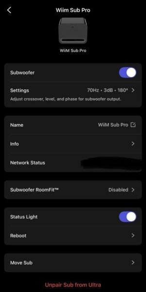

Note that I don’t have the Sub Pro wired to the Ultra, it’s connected to my Linn amp so the sub setting is off on the Ultra, but again all I get for the Sub Pro in that case is the shortened version.

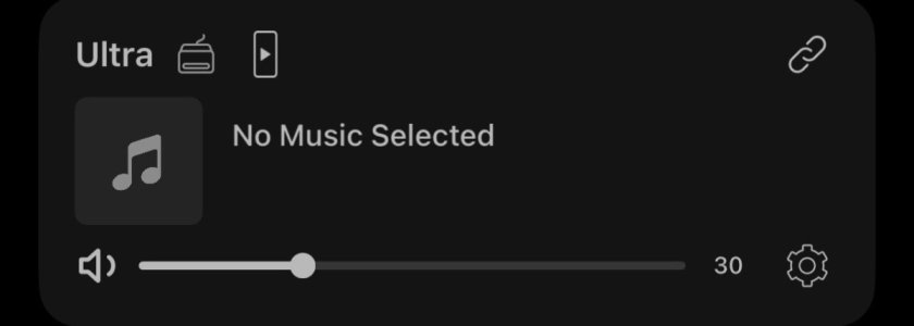

The Sub Pro doesn't have its own separate device "Tile" in the WiiM Home app, but instead there is a Sub Pro icon within the Ultra device "Tile", and this is located to the Left of the remote control icon.
These are the only settings currently available for my Sub Pro.
Does the Ultra's Subwoofer Settings get used (or prioritised) for wired connections?
... We need a detailed manual 🤔
The only subwoofer settings I have are those in the Ultra Subwoofer settings, see images in my previous post. :unsure:
