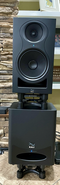

You can have a stack of powered coaxial main and dual-opposite firing sub like this; about $2,200 for stereo pair.

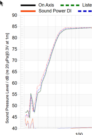

"the LSXII has no bass" is a true statement. Kef specify lowest frequency is 49Hz but that is at -6dB which means that the reproduced volume will be only a quarter of that for a 100Hz note of the same level. I have attached their specification sheet. The problem is more obvious if you look at the relevant section of the response curve, which Kef do not publish. I have attached a partial copy from a review at erinsaudiocorner.com.
The graph shows the output at 200Hz on the left and how it falls away as the frequency decreases to the right. For every 3dB reduction the volume is halved from the previous value.
Now back to how much bass you actually need. Both the pipe organ and electric bass go down to 20Hz which is considered to be the lowest note that a you healthy person can hear. at 50Hz those two insttruments are joined by double bass, piano,harp, harpsicohord, and tuba. A bass baritone singer can only go as low as 82Hz. So it is no surprise that for the vast majority of music (except for electronic and organ) 40Hz is adequate.
And finally when it comes to speakers there are two types of bass. First is plenty of noise with very little definition everything is a bit muddy and when two or more instruments are playing the same note you will not be able to distinguish them. This is often achieved in lower cost speakers. the second is where the notes are produced correctly and instruments can be heard seperately but total volume is less that in the first type. some exceptional speakers can be of the second type but give even more volume that the first - back to B&W 801!
