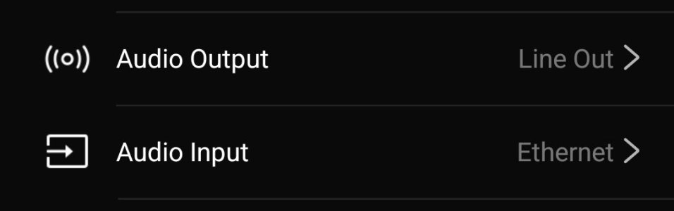

You can’t loop back into the Ultra like that as it only supports one output at a time, so it can’t output to both usb and line-out simultaneously.
What are your settings on the Ultra for input and output when you’re doing this and what’s your music source?

Tidal and I'm listening to it now, so I believe they did some updates recently to support multiple outputs.
I must admit I'm confused too.
To play tidal the input must be wifi/ethernet. To listen via line in the input must be line in.
Can't have two inputs at the same time, nor two outputs (subwoofer aside).
Seems to me it must be tidal straight to line out, as the screenshots suggests, not going via the smsls at all.
Tidal by Ethernet, USB out to the two SMSL devices. (WiiM even detected the DAC by name, quite a surprise.)
So optical from the clocker to the DAC, line out from the DAC to line in on the WiiM.
Line out from the WiiM goes to the integrated.
Sub out goes to the Vibelink to the woofers on the bi-amping.
Now turn the smsls off. Does it still work?
Because you simply can't have two active inputs on the wiim.
I'm sure Wiim also confirmed that you can't 'dac loop' the ultra.
And even if you could, the line in is digitised, and then the ultra's dac converts it again.
Sounds like the reclocker is not used then.
Input is Ethernet.
Output is Line out.
Sub out works in parallel with Line out or optical out or USB out, the same.

Sound like the reclocker is not used then.
Input is Ethernet.
Output is Line out.
You are all correct, now I'm truly confused. I powered down the DAC and the sound disappeared and yet when I set it up earlier there was a musical clip from SMSL that I listened to.
So when I went to look at it actually reverted back to ethernet and line out.
