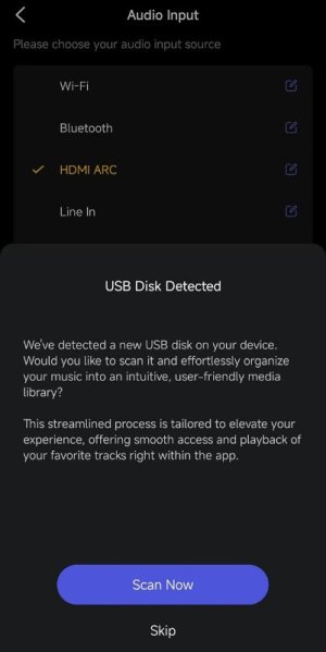

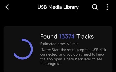

WiiM Amp Ultra. 1 TB USB thumb drive. 13374 tracks (mostly FLAC, a hand full of MP3s), 1004 albums, 701 artists. No wiim_cache folder, no .uuid file, starting from scratch.
4:57 pm: Thumb drive attached, hitting "Scan Now".

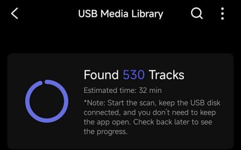

4:58 pm: After detecting 500 tracks very fast, the estimated time is 32 minutes. That would be 5:30 then. Not going to happen.

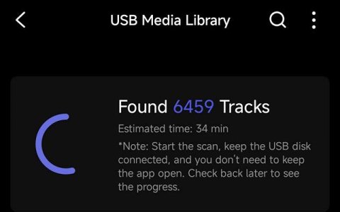

5:29 pm: After 31 minutes the remaining estimated time is 34 minutes. So, 6:03? Maybe? Almost!
6:07 pm: All 13374 files have been scanned.

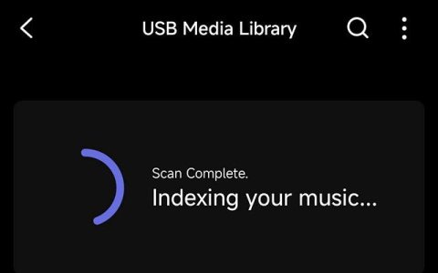

Still 6:07 pm: The index gets built.

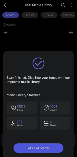

And still 6:07 pm: All done.
Total time to complete: 70 minutes.
