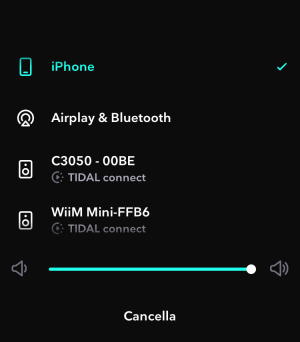

Maybe are you using the mini from ipad through Airplay2?
This could explain the 44.1KHz 16bit.
Thank you for the Suggestion!
Yes I am selecting Wiim Mini-FFB6 device in Tidal Connect Cast
