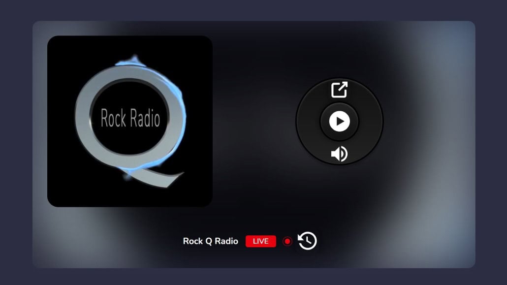

http://radiostream.mrtodd.net:8000/stream
This URL works with WiiM Pro Plus' latest firmware (4.8.628343). Please verify that your device is running the latest firmware version. If there's stuttering, please change your preferred DNS server to 8.8.8.8 in the WiiM Home App and see if it makes a difference.
Regarding your second query about Rock Q Radio, this URL is for a webpage, not an audio stream URL. Please obtain the correct stream URL and try again.

If I am not mistaken, the Rock Q Radio website is the source/info for the first stream link.
