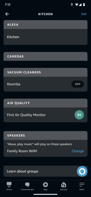

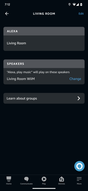

What speaker setting are you using in the second setup with the Dot - a similar room/device group contains the echo and the Wiim set as preferred speaker for the group, as compared to it being set as the preferred speaker for the echo in the echo’s device setting?
Posting a few screenshots from the Alexa app might help

It's the former setup using a device group. Kitchen works but Living Room does not.
Edit: Thanks for the tip, it looks like I had inadvertently changed the device speaker setting not just the device group speaker. I've changed the device speaker back to built-in which I think should fix this. Much appreciated!
Thanks - those look good. Can you take the Dot out of that group and create a new group with the WiiM as default? If you change the WiiM to another echo, does that work? I'd also ask the Dot "Alexa, is there an update?" then reboot it, and maybe even your WiiM and router
See my edit, I think it was the per device speaker setting that was screwing it up. Will test after work.
