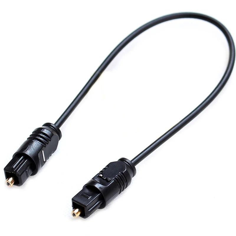

i spent 2.5USD on a short optical cable on AE and it works fine 🤐
