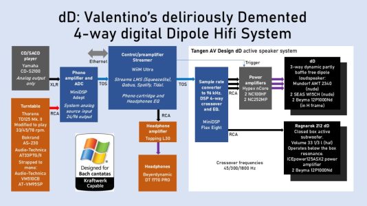

Details above. I've always used class D amplification and DSP crossovers/eq. To use something else you'd have to be dipole hero Siegfried Linkwitz. Until MiniDSP came along with their Flex Eight I had a PC running the filters under Console and a RME Fireface UD sound card. That PC is now running LMS for the setup. Peak volume in the listening position is a Mahlerian 108 dB(A).

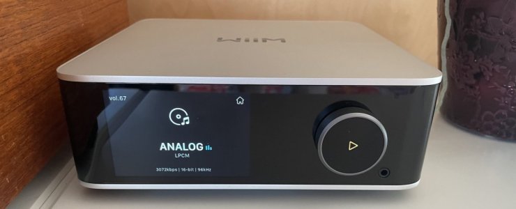

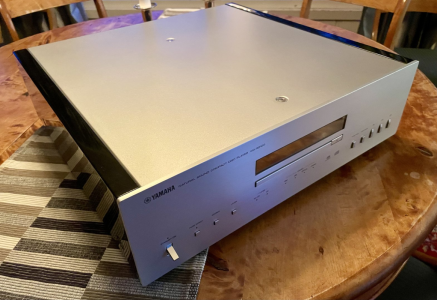

Bartok in the winter sun. A system upgrade now would have to be the new and modestly priced MiniDSP PocketADC between the phono amp and Ultra, and move the CD player to Line In. The Ultra analog input specs could have been better, but the CD player is only used for checking out if the music on a CD is worth ripping anyway. And look good of course. I love the Yamaha facias.
I took the full plunge and swapped my Cambridge Audio Alva Duo phono preamp for a MiniDSP ADept phono preamp/ADC.
The ADept now handles all system analog inputs and feeds them to the Ultra on optical 24/96 (even if the Ultra display says 16/96. Known issue. I wish WiiM could revert to 24 bit since that’s what optical is anyway).
The rest is just the same: Ultra feeds the speaker system on optical out and the headphone amp on analog out. Trigger out turns on the six main speaker amplifier channels. Some minor phono cartridge and major headphones EQ in is performed in the Ultra. The speaker system EQ/RC is all in the MiniDSP Flex Eight.
This is hardcore. I just had to make proper use of the differential (XLR) input on the MiniDSP ADept, so I got myself another analog source:
The revised block diagram:
