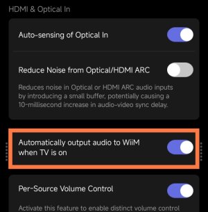

Hi
Have you already tried switching this toggle on/off?

With "Automatically output audio to WiiM when TV is on" disabled this should not happen, no matter what your TV CEC is configured to.
You should raise a ticket to WiiM (from the WiiM Home App Feedback) when this happens.

As @hgo58 said, please submit a ticket after reproducing the issue. A device log will be sent.
Also you can try the following.
1) Unplug the Ultra and TV power cables.
2) Unplug the HDMI cable.
3) After 10 minutes, plug in the HDMI cable again.
4) Plug in the Ultra and TV power cables.
(This may, in rare cases, solve HDMI issues.)
