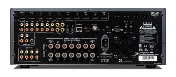

Could you post a picture of the back of your amp/ultra and give me the model no of your arcam gear? as I have arcam gear too.

Hi. It’s an avr550 home cinema amplifier. It’s very difficult for me to get a proper view of the back panel to take a pic, but here is a generic pic from online. I’m using the supplied Wiim rca lead from the rca outs of the ultra to the pvr input on the Arcam

OK I am just going to look it up. Hang tight but I think it may be the input on your amp
I'm not proficient with Arcam receivers, but some AVRs support (or require) some "routing" of their inputs. Maybe the stereo direct setting bypasses all this.
As long as you don't feel limited by stereo direct mode, just keep it like that. Or have a closer look at the configuration options on screen (or in the manual).
Thanks. I’m happy with the current configuration so will leave things as they are. It’s quite a hassle getting to the back panel of the Arcam, as it weighs a ton and is in a custom unit along with all my other hifi/home cinema electronics.
