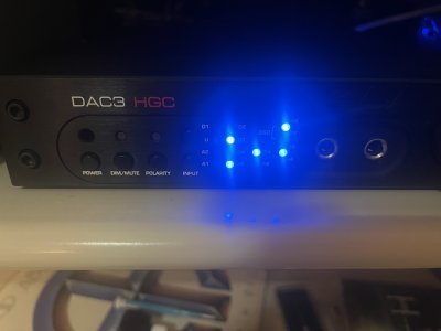

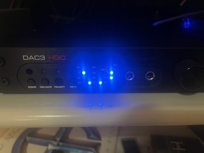

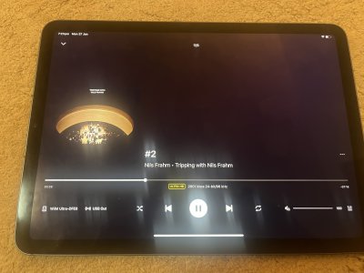

Hello everyone, I have exactly the same problem...
I have a benchmark, Dac3 Hgc.
With the coax, the sampling is correct, but with the USB obviously not. Something is wrong with the USB output. If I go directly into the DAC via USB via the Amazon Music app on the iPad, the sampling is correct.
The pictures are for illustration.

Tbh, I’d be surprised if the usb output from your iPad was correct - the Amazon music app tends resample everything to the resolution of the device it’s attached to and might even top out at 24/96. I can’t really make out what your images are showing.

The pictures, USB (U) 16/48 and via Coax (D3) 24/48 available.
