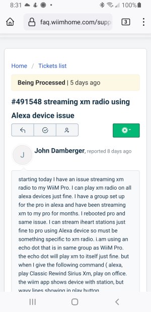

Within the last month or so, I have found that I am no longer able to use any of my Alexa voice devices to send Sirius XM to my WiiM Pro or either of my 2 WiiM Mini. They all worked fine in the past. Attached you will find the ticket I opened for this issue. I would encourage anyone with the same issue to open a ticket in the hopes that WiiM will put forth the resources to resolve this issue.

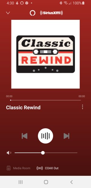

Unfortunately, I am not one of the lucky ones. I followed your directions step by step and no luck. If you look at the attached, you will see the small squiggly lines in the play button. WiiM sees the Alexa voice requested channel, but no sound.
