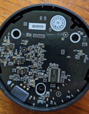

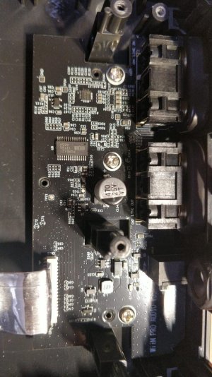

What DAC is in the mini and pro?
No. The plus has an AKM while the amp has ESS DAC. It was originally reported that the amp would be basically a Pro Plus plus am section, but for some reason they changed the DAC
Hello! In Wiim AMP - ESS SABRE 9018S?
