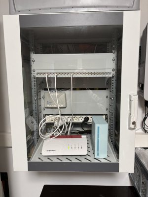

My first router was a Fritzbox. So is my current one and all the others in between. My access points are Fritzbox products as well. In all these years I have never experienced one single problem with any of their ethernet ports.
I'm using all four LAN ports plus the WAN port (configured to LAN) for my NAS and the access points.
Having said this, due to my hard-wired access points across the house I have excellent wifi coverage. In effect there's not a single end-point device that's connected via ethernet.
