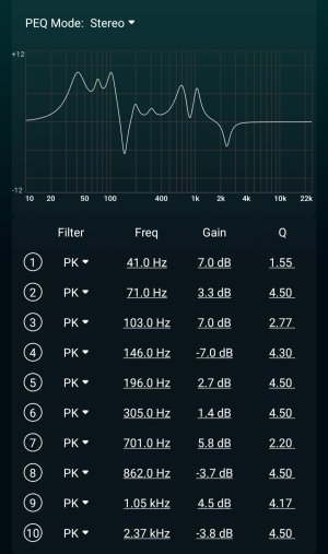

When playing Radio Paradise at 50% volume into my (relatively low impedance) LS50 Meta, my Amp settles at 12-13⁰ C above ambient temperature.
This is with some good bass EQ applied.

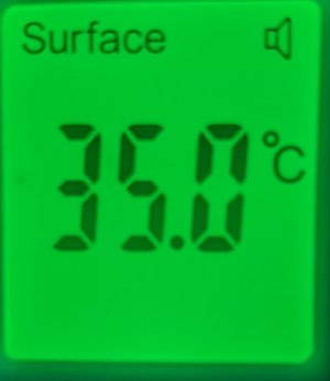

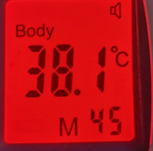

I did wonder if you had used something like that. I just dug out the thermometer we bought during the pandemic. I think my amp has COVID 🤣
Some infrared thermometers try to correct for different emissivity properties of different materials.
"Surface" should hopefully be more accurate than "Body". Mine gives me a choice between 0.95 and 0.8 without mentioning which might be suited two what surface. :p
The worst things to measure are shiny metal surfaces. Sticking a bit of black insulating tape on them helps.
