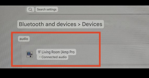

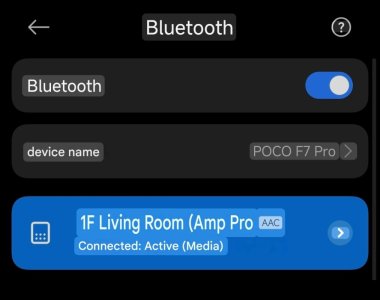

I was able to pair both my Win 11 PC and my phone to my WiiM Amp.
PC
Phone
When I play YouTube on my PC, I hear sound fine from the Amp pro.
Here is the connection procedure I followed. (Unpair all devices connected to the Amp beforehand.)
  1. Switch the Amp's input to Bluetooth.
  2. On the Bluetooth screen of the PC, click "Add Device" and add it as a Bluetooth audio device. (Do not pair with "Others")
  3. After successful pairing, test the operation on YouTube.
  4. Switch off Bluetooth on the PC.
  5. Switch the Amp input to Wi-Fi and then to Bluetooth.
  6. Pair the Amp on the phone's Bluetooth screen.
  7. Test with the phone's YouTube app.
After disconnecting the phone from the Amp, I turned on the PC's Bluetooth and reconnected to the Amp, and the PC's sound could be played from the Amp.
