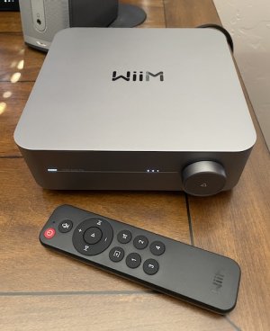

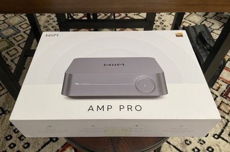

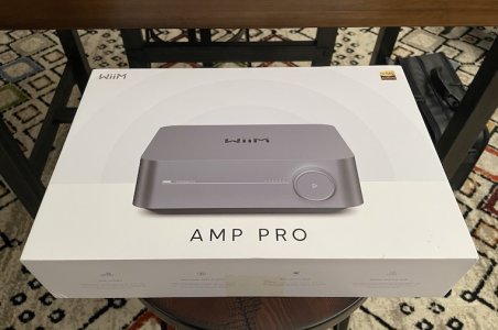

A WiiM Amp Pro arrived for evaluation today.
The well done package which includes the unit, remote control, 120V US plug/cord, toslink, line RCA pair, and HDMI cables and a brief User Manual.
Configuration is the usual WiiM app-driven process - plug the unit to power, open the WiiM open app and add the device. Very straightforward, especially if the app already manages other WiiM devices. During that process the app also did a firmware update.
Connect the Amp Pro to a pair of speakers and music plays. My evaluation focus is on using the Amp Pro as a streamer/amp connected to a pair of passive speakers used as a self-contained compact audio system. This can be used in a variety of environments, including office, small room, garage, etc. Compact and remotely controlled.
I am evaluating its performance with two 'book-end’ types of speakers - a high end 6 Ohm Magneplanar on one end, and on the other a fairly compact Neumi BS5 (6 Ohm, 2-way, 5” woofer, 1” tweeter) sold at Amazon for the incredibly low price of US$110. The main focus of the evaluation is using the Neumi pair. I connected the Amp Pro to the Magneplanar first and it behaved well, but bear in mind Magneplanars prefer high current high power speakers, so this is not the ideal load for the Amp Pro. The unit matched well with the Neumi BS5 and I am sure it will match well with a variety of speakers such as Klipsch (high efficiency), Elac, PSB, etc.

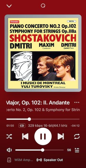

I used a variety of wide frequency range tracks, classical mostly, to check imaging, dynamic range and speed. I tend to concentrate on piano tracks, large symphony orchestras and small jazz and close-mic voices. Here are a couple of examples:
The Shostakovich Piano Concerto No. 2 is good to appreciate the delicate passages of the slow movement against the wide ranging forces of the orchestra. Here is a live in-room acoustic spectral analysis of that piece, where we can see a fairly smooth frequency range with the desirable in-room slope (no EQ, no Room Correction) at a peak 77.6dB SPL:
The piano image is solid and well separated from the orchestra. The orchestra image field is wide and stable.

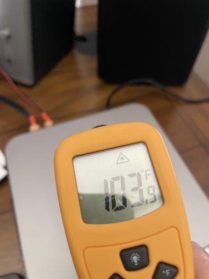

The unit operational temperature is 103F (40C) in my 78F (25C) ambient temperature room:

The unit operational temperature is 103F in my 78F ambient temperature room:

Re: Operating temperature. Is the USB connection on the back a two-way? If so, and a user is not using it for actual data transmission, I think one of those old-school, USB-powered tiny fans would dissipate the ambient heat pretty easily. They're available on Amazon and aliexpress for less than 5 bucks last I looked.
Nothing wrong with the operating temperature. No need for a fan. The 103F (40C) operating temp was doing a long period with the amp playing quite loud. Idling temperature is a cool 89F (32C). As a term of comparison, a headphone unit nearby operates at 118F (48C) and works fine.
buy a device of this type, not designed to be hidden, to stick a small external fan on it..where will we go?
the situation we encounter with the latest fosi is quite terrible... and worse seems accepted...:rolleyes:
the precaution of sticking to 60w and efforts on the dissipation side of wiim seems well-timed...

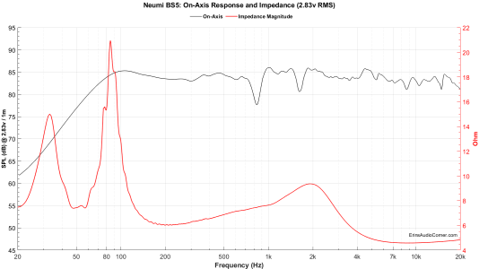

( even if more complicated, i have just crossed the impedance measurements of your little speakers used..seems to be a good fit for this kind of situation and will not highlight any possible complications with this kind of approach ..even without pffb it could have worked I think... ;-) )

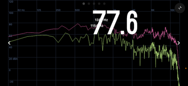

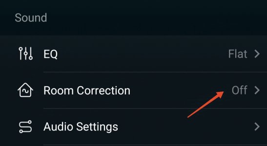

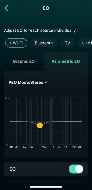

When setting a PK midbass filter (just a small notch) I notice the Room Correction was activated - this when prior to creating the PK filter RC was off. Is that correct behavior?
Yes, that is the normal behavior of the current WiiM RC.
*The display on the device screen (your first image) is not a real-time display and may not be noticed.

I was not referring to your image.
As you can see, turning on EQ is not immediately reflected in the device settings screen and RC remains off. However, RC is actually turned on.
This was a supplement not directly related to your question. Sorry.🙂
Interesting, but in this Amp Pro FW, RC is marked on in that screen and in its page, even when I did not turn it on. So… your observation was a good one. 😀

"Vocals greatly improved. The rawness is now evident."
"Perhaps lacking a bit of 'oomph' now, has RC tamed it a bit too much?"
"Cymbals much more evident, stands out from background now."
"Far better stereo separation."
The RC added 4* 2.5db dips at both 41hz and 106hz. For me, that took away some of the 'thump' I've probably got used to.
Since then I have manually adjusted the RC to bring back some of the bass.
As for what caused that initial, woeful, experience?
No idea. Toggling between my RC settings and EQ off now simply sounds like I'd expect - less/more bass, more/less overall cohesion.
So, my conclusion (if a short time listening in one room / setup can be called a conclusion).
