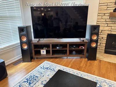

Did a lot of testing, and feel Amp Ultra's sound quality is like 25% better than Amp. Not scientific by any means, just based on subjective listening tests. Also asked my wife & two kids (17- & 20-year old) to give me their impressions. A significant plus w/Amp Ultra is that it can handle louder volumes & do so better. So, keeping the Amp Ultra & will eBay off the Amp.

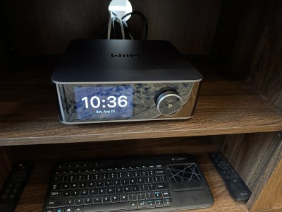

The display is a nice to have, but pretty useless for touch-screen use (as the app is far more convenient) & from my listening position 11' back, can't really see the cover artwork, or even the VU meter that well. The clock is nice to see when device is in standby.

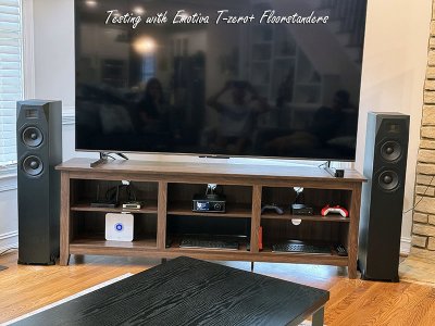

What I did do was test the playlist above w/different speakers I had on hand—Emotiva T0+ floorstanders, and clarity/details stood out more than Klipsch's. Bass is a little better on latter, and it can handle louder volumes a little better, but sound quality overall was better on the Emotiva. Now, this is the rabbit hole of electronics... I'm wondering how much better higher-end Emotivas might be, or another pair of quality speakers. Curious what you all have & how you like them.
