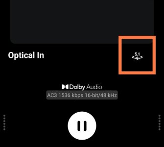

Is this icon not appearing on the WiiM app's playback screen?
If so, please unplug the device's power cable, leave it for a while, and then restart it. This sometimes resolves temporary errors.
Also, what is your playback source? If possible, please try playing a 5.1 video on Amazon Prime Video.
@Wiimer,
Thanks for the quick response. Yest the 5.1 icon highlighted in the image posted by you is not visible. I will try to unplug and restart the WiiM Amp Ultra, and revert to you.

Tried to play 5.1 movie from Amazon prime app on XGIMI Halo+, however, it only shows Dobly Audio AC3(exactly as showing in your pic), but no 5.1 Icon.

This might be a silly question, but is the WiiM Amp set as the group leader? Could you please post screenshots of the device card screen and the playback screen?
Thank you @Wiimer. I have unplugged the WiiM amp ultra for some time, re-connected and re-configured it & it worked. Now, I am unable to get 5.1 sound from Prime Video app on my projector.

Based on this information, your projector may only support PCM output. Please contact the XGIMI support. If your projector’s HDMI settings allow you to switch between pass-through (bitstream) and PCM audio, try switching to an option other than PCM.

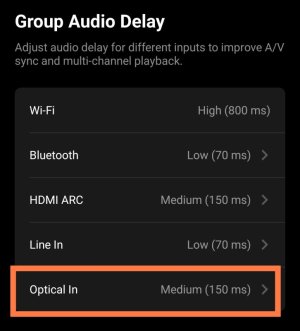

In the "Group Audio Delay" of the Audio Input section, set the delay for the optical input to 150 ms. (A delay of 70 ms may cause issues such as audio dropouts.)
Then, adjust the lip sync on the Fire Stick. In my case, this fixed the audio sync.

It didn't work for me. I tried to change to 70ms, 150ms and 800ms, none of the options helped in resolving the issue in 4.1 mode. However, when I switched to 2.1 mode there is no issue with lip sync.

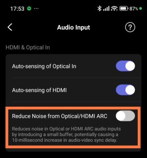

Is "Reduce Noise from Optical/HDMI ARC" disabled on the audio input screen? Enabling this feature increases latency, so if it's turned on, please try turning it off.
