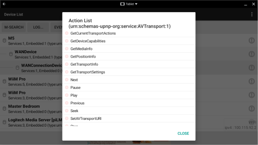

Get yourself a good UPnP tool, which will search your LAN using SSDP for all your devices, display their methods, and allow interacting with and subscribing to their services. They are available free in the iOS and Android App Store, probably Windoze too.
There are plenty of UPnP libs on GitHub for Python and Node.js, probably other languages. There are Sonos libs in both languages, good examples, though not exactly the same as WiiM’s interface.
For an example of doing it raw, without a lib, see one of my Chrome extensions.
UPnP Tool (Android):
Thanks everyone for the replies and thanks a lot to cc_rider for the detailed instructions regarding UPnP.
I managed to get the UPnP Tool to work and it's pretty interesting. Before I always thought UPnP was for just automated setup of certain hardware only, but I've learnt something new now :)
I've explored all the functions that the WiiM UPnP interface provides. For my use case I could consider switching to the UPnP interface instead of the HTTP API, however, the only advantage it may provide me at this moment is that the "play/stop/pause" status could be more accurate from the UPnP interface (although it "seems" like the actual playback status through the HTTP API has become more accurate recently, maybe since recent WiiM Pro firmware update).
