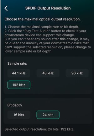

Wiim home app, device menu, settings (cog), audio settings, mqa core decoder
Have you set the Output Resolution in the Wiim app? It's under Device > (Gear Icon) > Audio settings > SPDIF Output Resolution (or Coax if you're using that) . I run the Wiim pro optical out into my Denon and it plays at 192/24
