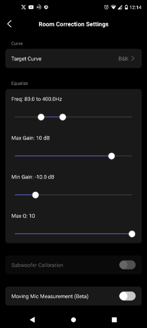

This is a bit confusing what are the two settings main gain and min gain?
One allows you to set the max positive gain while the other limits the negative gain. It was an addition after users asked to split out positive and negative gain from the previous single figure which covered both.
It needs better wording, to those in brackets
So the top one is max positive gain (max boost) , the second is negative gain (max cut)
And if you think about it, negative gain and positive gain are just the same as cut and boost.
It's a matter of taste, I wouldn't mind either wording. Sticking with gain probably makes it easier to translate.
