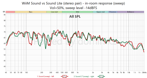

However, now having two WiiM smart speakers I could test a few additional use-cases.

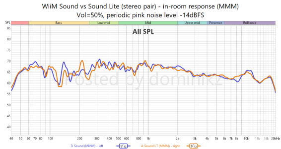

  • Pairing the WS with WSL in a stereo pair helps hide some of their tonality sins. 🙂The added width and depth of stereo takes the focus away from tonality issues, which definitely improves the experience.
    • Still, adding PEQ on top to tame the excessive treble can improve it a bit.
    • However it is not without issues: in direct level-matched comparison (even with corrective EQ configured) the WS(L) pair is still brighter and not as smooth in the midrange as my Revel M16 pair.
    • Stereo soundstage seemed a bit undefined/unstable to me - it has an almost "phasey" sound to it (like some kind of phase cancellation thing is happening). This is very apparent when comparing side-by-side with my Revel speakers.
    • Grouping and channel allocation seems to persist after standby, which is nice.

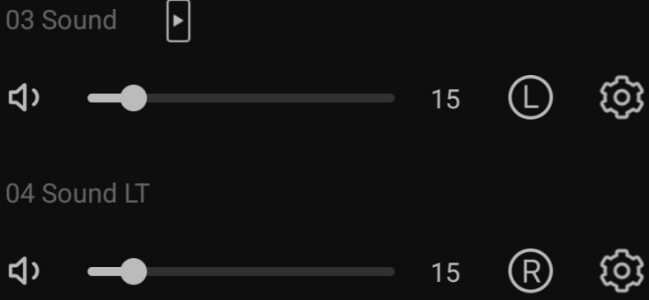

    • There seems to be an issue with the follower device not following volume of the main speaker every time, especially if using presets to adjust volume. I've opened a support ticket on this.
  • I've also tried the WS+WSL as surround L/R in a Dolby 5.1 configuration with the WAU driving a pair or Revel M16 as front L/R and a SVS SB-1000 Classic subwoofer. This worked fine and was actually quite fun to try. 🙂
    • But the current limitation where RoomFit/EQ are both inoperable with 5.1 content is a serious issue. Without bass correction (RoomFit) it easily gets too boomy, and without EQ the surrounds don't match the fronts on tonality. Until this functionality is added (SurroundFit?) I don't believe I'll actually use 5.1 much.
  • Lastly, I tried "double stereo" playback by grouping WS [as L], WSL [as R] and WAU [as LR] in the same room, but opposite sides. This was far from being accurate (there's no sound stage to speak of), but it was fun to try. 😊

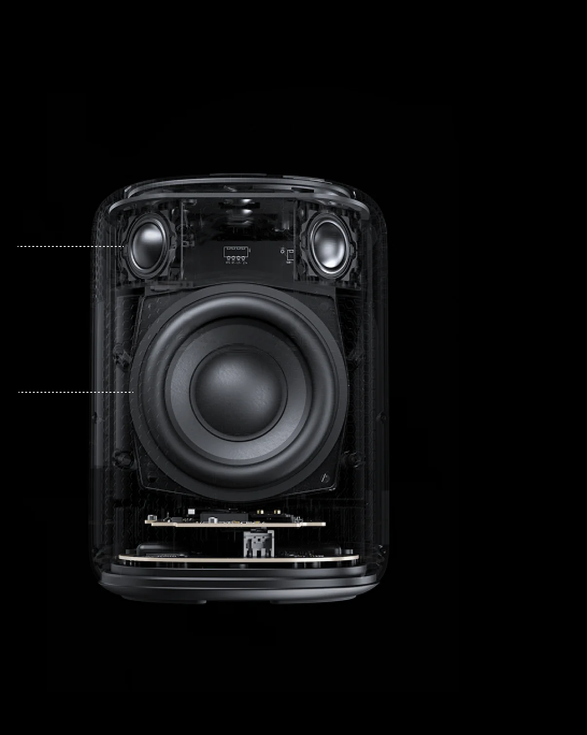

What's up with the dual-tweeters?
Now isn't that an interesting question? :)
As we can see from the marketing pictures, the two tweeters are pointing approx. 45° to the sides:
The intention was I guess to:
  • Make the sound dispersion wider
  • Allow for 'true' stereo playback with a single speaker, i.e.:
    • Above the crossover frequency (2.4kHz):
      • The left tweeter plays the left channel only
      • The right tweeter plays the right channel only
    • Below the crossover frequency (2.4kHz):
      • The single woofer plays a sum of both left and right channels
This sounds nice in theory, but in practice it IMHO brings several challenges:
  • Two tweeters mounted on the same speaker will cause a complex pattern of acoustic interference in the dispersion. We'll see that in the following sections. My assumption is that this is what causes the "phasey" sound when pairing two speakers in a stereo group.
  • We can't really perceive a stereo soundstage if both tweeters are so close together - unless perhaps if our room dimensions are really lucky, and speaker is placed optimally to reflect the sound from each tweeter's adjoining side-wall exactly to the listening position.
NOTE: So with both WS and WSL speakers the dual tweeter operate as follows:
  • If we play a file where left and right channels contain a different signal, each tweeter will play the respective channel signal.
    • This is what happens with regular stereo audio content on a single speaker, or when WS or WSL are configured with "LR" when added to a multi-device group:
  • If we play a file where left and right channels contain the same signal, both tweeters will play the same signal.
    • This is what happens with mono audio content on a single speaker, or when WS/WSL are configured to each play a single channel when added to a multi-device group (e.g. "L", "R", "C", "SL" or "SR"):

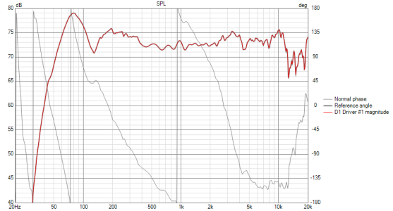

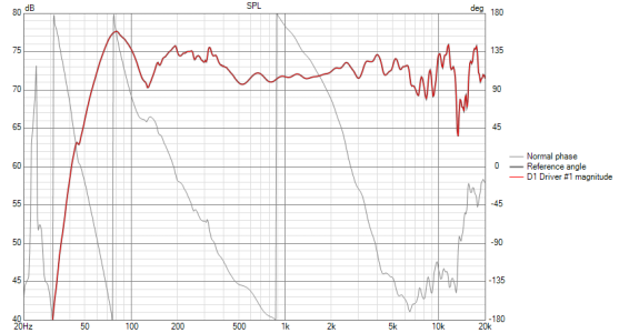

WiiM Sound (WS) - on-axis response (left and right tweeters play the same signal):
WiiM Sound (WS) - on-axis response (only the left tweeter plays, right tweeter is silent):

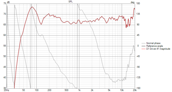

WiiM Sound Lite (WSL) - on-axis response (left and right tweeters play the same signal):
WiiM Sound Lite (WSL) - on-axis response (only the left tweeter plays, right tweeter is silent):
We can see that both WS and WSL give a very similar response, which is unsurprising given the identical architecture.
There is a peak in bass response around 70Hz, followed by a dip around 130Hz. The response above that is kept within +/- 2dB until about 12kHz, which seems pretty OK at first glance. Above 12kHz the response is chewed-up, likely due to some kind of acoustical interference caused by the physical design of the device.

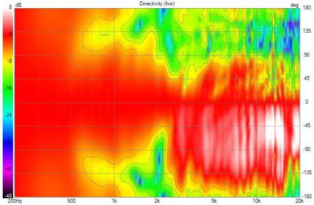

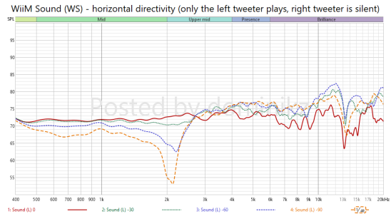

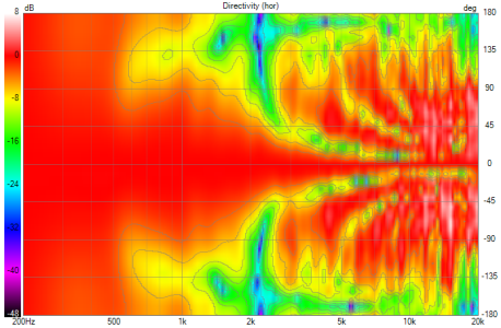

But the really interesting part is the horizontal dispersion/directivity - here only shown for the WS, but the same applies to WSL.

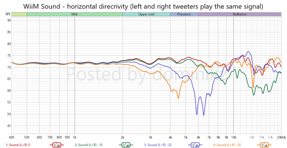

WiiM Sound (WS) - horizontal directivity (left and right tweeters play the same signal):

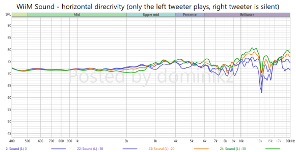

WiiM Sound (WS) - horizontal directivity (only the left tweeter plays, right tweeter is silent):
While directivity is indeed pretty wide with both tweeters playing, it is riddled with cancellations when we move off-axis - unfortunately a natural product of this kind of acoustic design.
Here's how that looks if we compare responses between 0°-30°:
With only one tweeter playing, there is no cancellation, but there is directivity discontinuity around the crossover, at least in part due to physical misalignment of the tweeter and woofer. However the responses from 0°-30° are much better aligned to each other, because now there's no interference with the other tweeter:
So where does the brightness come from?
By now I hope we could see that the brightness issue is caused by the dual-tweeter design, and the resulting directivity mismatch between the single woofer and the tweeters. Basically to get a flat on-axis response (which is actually 45° off-axis to either woofer), both tweeter level need to be pretty high, which generates a lot of off-axis high frequency energy. Combine that with the cancellations caused by dual-tweeters, and I'd say that explains a lot of the issues I'm hearing.
  • If we play a file where only the left channel contains a signal, while the right one is empty then only the left tweeter will play, while the right tweeter will remain silent.
    • This can currently only be achieved with test or manipulated audio files, by leaving one channel empty.

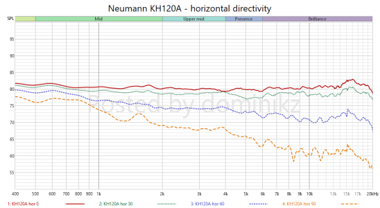

Let me try to illustrate with another diagram; if we move from 0° (on-axis) to 90° (off-axis) on WS or WSL, we start to get less energy in the upper midrange, but more and more energy in the treble. This is because when we move away from the front of the device we also move towards the tweeters, which are aimed at ~45° angle to the side, and so naturally radiate more energy there (responses at 0°, 30°, 60° and 90° horizontal angles are compared below):
Compare that now to the behaviour of a really well-designed traditional loudspeaker (front-firing, single-tweeter), in an equivalent measurement:
As we can see, while the on-axis response target is also flat, the off-axis responses show a progressive reduction in treble energy. Actually, with the Neumann above 10kHz the response at 90° angle is almost 20dB down (subjectively roughly a quarter as loud) compared to on-axis
Now look at the previous diagram and notice that with WS/WSL the response above 10kHz at 90° angle is actually higher than on-axis!
The result is that WS/WSL sound bright, while KH120A sounds balanced - even though they were both designed with the same flat on-axis response target in mind! The difference is simply caused by the different sound dispersion characteristics of the two designs.
IMHO if WS and WSL were designed as 'mono' speakers (like the KH120A example above), with just a single woofer and single tweeter, they would have likely sounded better.
This would then be a traditional two-way front-firing design, where horizontal directivity could be better controlled (with some care in development), there would be no excess treble energy, and off-axis interference caused by the two tweeters would have been completely avoided.
I'd personally prefer such a design - it would be ideal for use in multi-speaker groups (stereo or multichannel)!
The dual-tweeter design WiiM opted for with WS/WSL (to have "stereo playback" with a single unit) makes it much more complicated to make a neutral-sounding speaker. IMO it is obvious that in this case a simple "flat on-axis" doesn't work, but at least to my knowledge there are no industry guidelines on what the target *should* be in such designs. This means significant research effort would be required to get it right.
So in that sense I can understand that WiiM had a pretty difficult task on their hands here.
Lastly, WiiM make streamers and streaming amps that can compete with devices at any price on both sound and features, not to mention the amazing support.
So my expectations for the WS and WSL were really very high. But loudspeaker design brings new aspects to the table, so perhaps it is not so surprising that their first attempt is not perfect in every way. :D
In any case I'm excited to see what they come up with in the future! :giggle:

It makes you wonder why WiiM came up with their own speaker design when they already had a partnership with Audio Pro, another experienced speaker designer.

When comparing the on-axis response, it appears that the volume of the WS is about 1 dB higher than that of the WSL in your case. In my case, it’s the opposite. Does this mean it’s just a slight variation between units?
I measured the WS and the WSL on completely separate occasions, so I can't guarantee the levels were set identically both times. The level mismatch could also be because of that.
But I can definitely test for this specifically and report back!
Here's a quick and dirty test.
For both of these tests WiiM Sound (WS) and Sound Lite (WSL) were paired in a stereo group; WS=left channel and WSL=right channel.
First test was with the microphone centered and fixed at ~2.75m from each speaker, measured with a separate sweep for each channel (speaker), with the other muted in WHA:
The second test was measured using the moving microphone method, moving randomly at around 2.5-2.3m distance from each speaker. Again each channel (speaker) was measured separately, with the other muted in WHA:
Neither test shows any obvious overall difference in relative level between my two units. Seems they are reasonably well matched.
Perhaps worth noting that these responses are with RoomFit (non-boost mode) applied below 400Hz, plus a high-shelf PEQ to reduce the highs a by a few dB.
Maybe they wanted to have more control of the design? Who knows. 🤷‍♂️
In any case I for one applaud them for the effort, and hope we see more of their smart speakers in the future!
EDIT: Seems Amazon Echo 4th gen and Harman Kardon Onyx Studio 7 use a similar architecture as well. There are probably others.
I have a JBL authentics 300 which has front facing tweeter pair & single woofer and a downward facing passive radiator. It's a nice little package and for a long time i considered getting another one for stereo pairing. But finally went with a proper (WiiM) amp+speaker+sub instead. With a limited EQ and 4 tweeters and 2 passive radiators, it would have been a struggle if i had gone for stereo pairing I wonder.
Thank you for testing it.
It seems this was an issue specific to my device after all...
