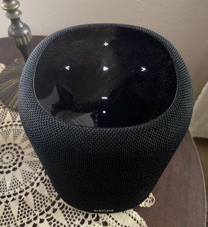

The speaker's top has a proximity sensor and once activated by sensing a hand it will illuminate convenient control settings (+ - volume controls, <- and -> channel preset controls and a center > pause/play control). A small pilot light is also present below the - control and it can be set always on or off by a setting in the WHA.

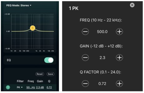

Sound presentation also depends very much on how the speaker is located and how close or how far it is from hard acoustically reflecting surfaces (walls). In my case I set the Sound Lite as an accent sound source in a nook of the house. It sits on a small table, about 35cm from the back wall. This position creates a dip in the low frequency range that can easily be corrected with a slight boost in that area:
Assuming the speaker is some distance from side walls, measure the distance from the center of the speaker to the rear wall - call it L. Calculate the attenuated frequency f:
f = 340/(2L)
where L is in meters, and f in Hz.
(Unit conversion: 3.3ft is about 1m. 12 in about 0.3m.)
Using the WHA parametric EQ, apply a PK boost at the frequency f, start with a gain of +2dB and a Q of .4 to .8. Adjust that in small increments while listening. It should produce a pleasantly balanced sound.
Here is the PEQ correction in my setup:
