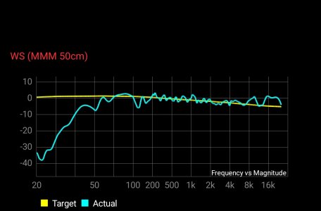

These are the results of running RoomFit Evaluation from the same positions (50cm) as during recording.🙂
WiiM Sound
A10
