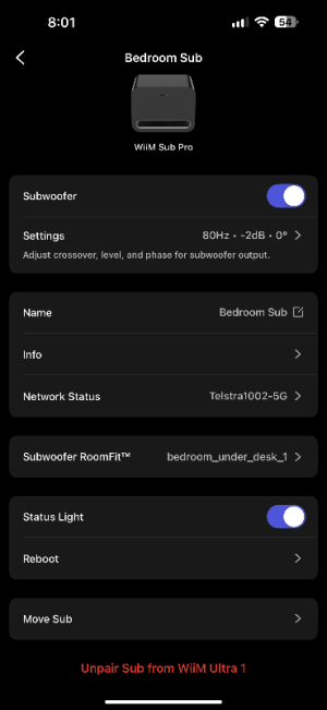

When using the WiiM Sub Pro paired with your WiiM Ultra, certain options are no longer accessible in the Sub Pro settings in the WiiM Home App.
If you want to access these additional options, you will have to unpair your Sub Pro from your Ultra.
Really? So you get fewer setting options with wiims own sub than with one from another brand? What's the reasoning for that? It seems somewhat counter-intuitive to me.
The Sub Pro can be connected by cable, and not paired to the WiiM device, and then the full options are available.
If the Sub Pro is connected to a WiiM device wirelessly, then this makes two settings unavailable.
This is also the case when the Sub Pro is connected to a WiiM device by cable, and also paired with the WiiM device.

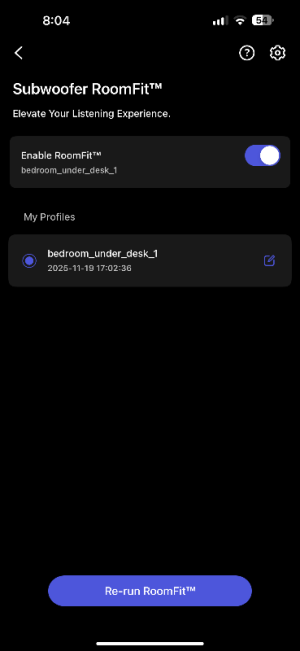

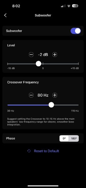

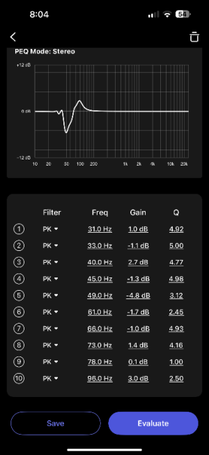

Don’t get me wrong, music sounds great with the wiim sub. Perhaps it could be better so why not chase after better integration at zero cost.
These are the settings when paired with the wiim sub.
I manually added a +3db at 96hz to fill the gap a little. The rest of the filter was generated by RoomFit on the sub.

I wonder what's inside the "Move Sub" menu.
There’s a pop up box saying “Do you want to move WiiM Sub Pro to another device?”, and the options are No or Yes.
Yes brings another screen “Select a Device”, and there is a list of all WiiM devices that are available on your network, and you have the option to select one.

RoomFit applies a high Q filter at the crossover to compensate for this.
Does the positive gain filter really do anything meaningful in compensating for the dip? If so, then it's OKish to apply it. But if the dip is really caused by acoustic cancellation there's not much to be gained and I'd rather remove it.
However a better overlap would avoid this.
I'm not onvinced, it might, and it might just not.
When you tried different crossover frequencies between 80 Hz and 110 Hz and the dip was always present, did move with the crossover frequency? Did you notice at least a slight difference in how deep it was?
