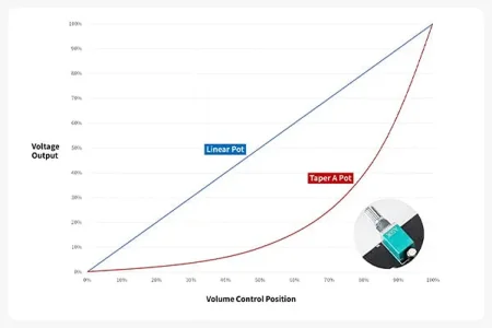

The volume pot of the ZA3 is a logarithmic taper type (als opposed to a linear taper type). This is very common with audio amplifiers because it represents our hearings sensitivity to sound pressure changes better than a linear potentiometer. But this also means that a a small twist on the knob will have a different effect, depending on how far you turned the knob already.
In the lower volume region (where channel imbalance tends to be worst) you need to turn the knob quite a bit to get a difference in output at all. In the higher volume range even small variations of the position of the knob will have a relatively big impact. That's why I personally prefer to have the volume knob in the well-defined max position in a scenario where the balance between the subwoofer and the main speakers can be upset if for whatever reason you change the position of the amplifier's volume knob.
