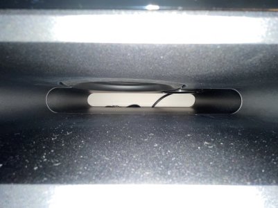

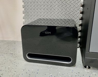

The Sub Pro is a handsome piano-black finished box with a bottom cavity, open front-to back. The subwoofer's driver and port are firing down into that open cavity.

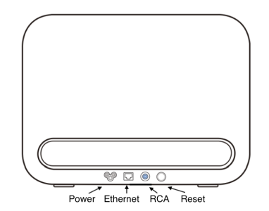

The Sub Pro has in the back left-to-right connections for Power, Ethernet, and RCA and a Reset pushbutton.

The Sub Pro manual recommends a RCA connection for best performance, but preferring to reduce cabling I opted for WiFi as a signal connection. I found that the WiFi connection worked just fine.

Is it possible to shoot the driver through the slot? I'm interested in the shape and arrangement of the port.
Excellent user review. Thanks.
The construction is interesting: A bass reflex speaker firing into a ported cavity. Depending on tuning one could achieve a 6th order acoustic rolloff.
Thanks for the detailed pictures and writeup!
So the sub can be connected via Ethernet or WiFi as a management path for firmware updates and device control, but also Ethernet/WiFi as a signal path in addition to the preferred RCA cabling.
