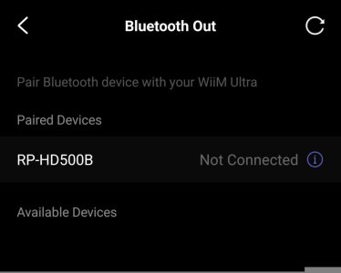

Hi
Can you confirm that the speaker appears as 'Connected' on the WiiM app's Bluetooth output screen? If it shows 'Not Connected', please tap the device name to connect.

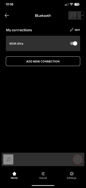

Additionally, please post a screenshot of the error screen displayed in the M2 app.

Well, nothing works.
I reset the Stereo M2, paired it again with the WiiM.
Still the same problem: Stereo M2 is marked as connected to the WiiM but no sound.
Teufel App screeshot :
