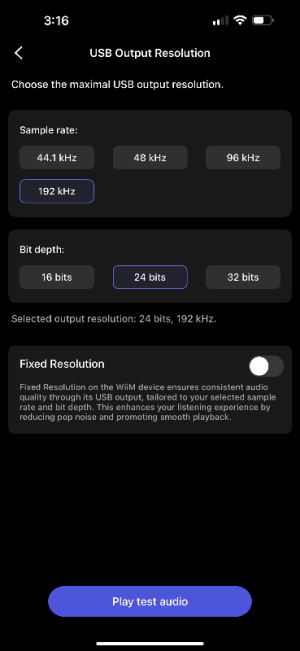

WiiM ultra can anyone tell me if you can select 16bit, 24bit, or 32bit bitrate when using usb out? I have been using usb out to my Berkeley Alpha USB version 2 and it has been working flawlessly for about 3 weeks. The Berkeley only handles bitrates up to max 24/192. If I look at the WiiM ultra usb out it recognizes it properly but only has the 32bit box and it is highlighted. I don’t have the option to select 16, or 24 bit. I am wondering if this is a software or hardware issue. Could anyone who is using USB out please check and see if you have the 3 selection boxes available.

Please let me know if you have selectable USB bitrates for 16, 24, and 32 from your usb out settings
I have filed a report with WiiM but haven’t heard anything other than it’s been assigned to technical support.
I have done a reboot, and then a factory reset, still can’t get any other selection other than 32 bit to show up under usb out.

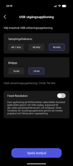

I have selectable 16-bit & 24-bit.

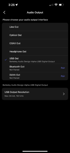

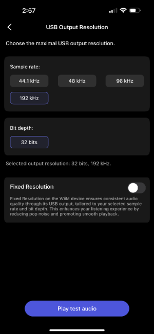

My Berkeley Alpha USB is capable of 24/192. The WiiM Ultra usb specs claim it is capable of up to 24/192 output. That would be ok and was working that way for 3 weeks, then poof, issues.

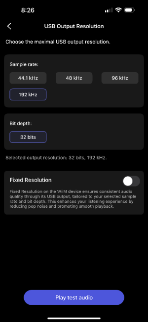

When I look at the Wiims usb selectable output it used to show 16, 24, and 32 bit. It only shows 32 bit now. See photo. I don’t have the option to lower the bitrate. Even if it’s not outputting 32 bit, there is a software glitch that is preventing it from playing anymore.

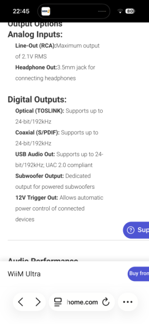

The specs for the Ultra‘s USB out.
192 / 24
I see the specs that states max output is 24/192 but the WiiM is glitching out that I’ve seen 16,24, and 32 bit selectable boxes but currently I have nothing lower than 32bit. I am at a loss and haven’t been getting far with support. I have hooked the Berkeley up in my main system and it functions normally. It worked for 3 weeks hooked up to the Ultra with no issues. It sounded wonderful. I’m hoping WiiM would send me another unit to replace this one. I may have to return it under warranty if I can’t somehow find an answer to this issue. I really don’t want to because I’m really pleased with the sound using an outboard dac and amp.

It stays stuck on 32bit depth. No other options appear.

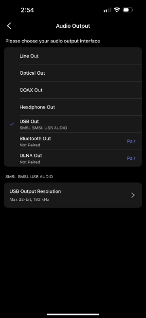

If I go out of the Wiim to a Smsl P0100 or directly into the Hifiman via usb, both work, although not as nice sounding as when going through the Berkeley when it works.
With the Smsl currently hooked up only 32/192 is available. I can change from 44.1 all the way to 192 but I can’t change off of 32 bit depth

I remember there being 3 boxes for selecting bit depth. But not available now. If they are reading what the dac is capable of and only offering that setting, that is incorrect and inconsistent. The Berkeley should not have a 32 bit depths available option. And others have stated 16 and 24 were available for selection and another stated just 32.
The attached pictures are with the Smsl attached. Note, no selection other than 32 bit depth.

I just hooked the usb cable up to the Hifiman Ef600 and it gave me the 3 choices for bit depth so I selected 24bit, confirmed it worked. I just now swapped the Berkeley back in and it’s working. But it could be for anywhere from 2-6 songs or if I change a playlist it will suddenly stops between tracks. See the three screenshots Hifiman with the three boxes, then the Berkeley with the description showing 24/192 selected and then I click the box to change resolution and it says 16/192 output playing and the other boxes are not there. Definitely something glitchy going on. Does WiiM tech support look at the forum
