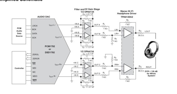

Goggling "can the TPA120A2 take an analog input?" suggests "Yes, the TPA6120A2 (often referred to in context with high-fidelity headphone amplifiers) is designed specifically for analog input. It is a current-feedback stereo headphone amplifier that takes analog audio signals, such as those from a line-in source or DAC, and amplifies them for headphones", which would suggest it doesn't have/need another DAC

I think you are right. It don't include a DAC on the chip. I was looking at this diagram (below) and was mistaking it for the chip. I cannot say how WiiM is using it.
