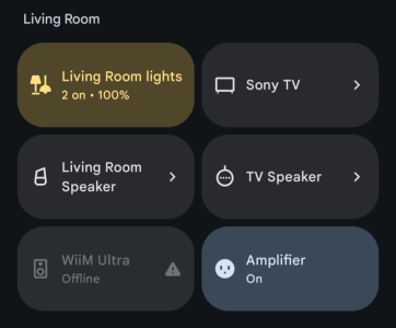

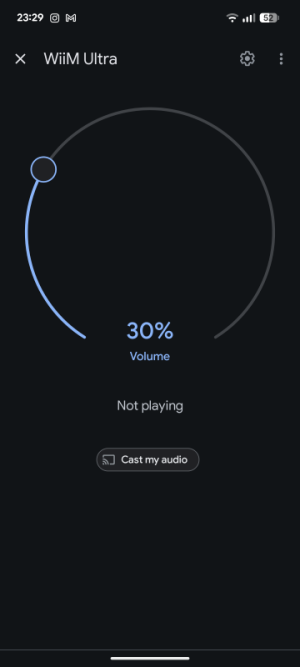

My WiiM Ultra is always shown as being offline in my Google Home app's device overview. However, I can perfectly open it and adjust its volume - making the Ultra (and my amp) go active if it was still in standby. Even when the Ultra is turned on and playing, it will still show as offline in the overview. It is working as a Chromecast destination just fine.
The main issue with it reporting to be offline is the fact that I'm unable to use it as the playback device for audio when asking any of my other Google Home speakers to play music. Even though I've set them to use the Ultra, they will default to the built-in speaker instead. The only reason I can think of is the issue with the Ultra showing as offline because this feature works perfectly between my different smart speakers.
I've already sent feedback through the WiiM Home app. Just curious if other people are encountering the same issue.1000047097.png1000047098.png

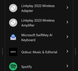

This may not be related to your issue, but could you go to the Manage Accounts page of the Google Account you are using with Google home, and check the connections for third-party apps?
Google Accounts >>
Security >>
'Manage connections for third-party apps and services'
Here you can view all third-party devices connected to your Google Account.

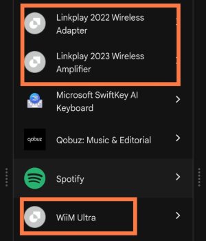

In my case, I can find two Linkplay adapters. Presumably 2022 is a WiiM pro and 2023 is a later WiiM device (including Ultra).
Removing these two adapters will remove the WiiM device from the room in the Google home app and return it to the local device. When I put the device back into the room, the adapters are reconnected and appear on my Google account.
And in my case, when I put the Ultra back into the room, the "WiiM Ultra" now shows up as new.
Again, this may or may not be related to your issue. (I honestly not sure..)
In any case, the Ultra did not go offline in all circumstances on my Android phone and I was able to use Google Cast even after removing the adapter.
Edit;
If I remove the "WiiM Ultra" adapter from my Google account, I can still use Google Cast, but can no longer play music from the Ultra via Google Speakers; when I put the Ultra in the room, it works fine again.
