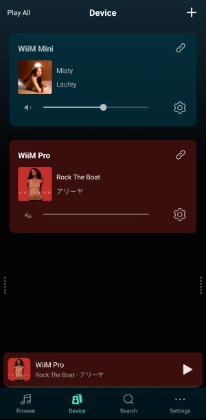

The WiiM home app lists multiple devices as cards, as shown in this picture.
When playing music in the WiiM app, select any device card and then select the song. When casting from a streaming app, the WiiM app is mainly used to manage the device.

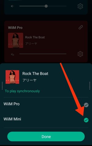

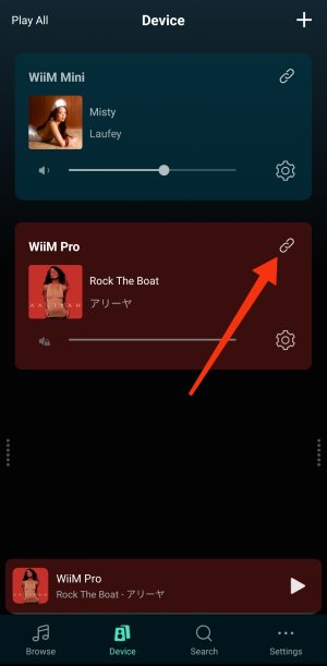

Tap the link icon in the device card to link that device to another device for multi-room music playback.
Click the link icon > Select a device

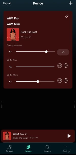

In this way, multiple devices are integrated into a single card, and you can control the volume of each device and more.
