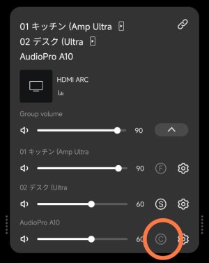

This is the case with the A10 speaker configured as surround left speaker - the A10 output icon is set to 'SL' and is responsible for the left channel.
This is the case with the A10 assigned to the center. The output icon is fixed at 'C'.
Please try 4.1 channels first 😄
