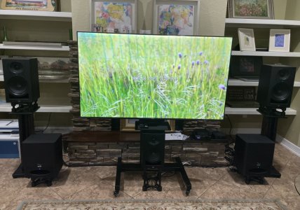

I added a center channel with WiiM Pro and Kali MM-6 monitor speaker to my current system (2.2 active monitors set up with WiiM Pro Plus and SMSL DO100 Pro). WiiM Pro shared same input with WiiM Pro Plus via WiiM group, Google Chromecast group, AirPlay group, or an active Toslink splitter (shwon on the third picture). I set up WiiM Pro as a mono output and output toslink to Kali MM-6 monitor (which has toslink, spdif, XLR, RCA inputs). I equalize WiiM Pro to enhance vocal frequency range and de-emphaise low and high freqencies.
Once WiiM gets room correction and additional equalization, I plan to apply RC to WiiM Pro and vocal enhancing eq.

Until WiiM Pro gets separate EQ and RC, I apply mono output and RC and use Kali MM-6's equalizer settings (it has dip switches at the rear panel) with low frequency trim and high shelf trim. When measuring for RC, I do not use low and high frequency trims. I can hear voice much better with this setup.

If I had to give one piece of advice it’d be to grab a mic, even your phone works, and try to manage the delay manually. Right now your center is probably arriving too early or too late compared to the mains which can smear the vocals or cause weird cancellations. Once you get the timing locked in at the listening position it should tighten up big time. REW would help too , you can do a group overlay and get it down exactly and set WiiM delay accurately.
I did autosynced center and L/R separately. It turned out;
Center: +14ms
L/R: +29ms
Not only physical distances are different but signal chains are also different - such as external DAC, subwoofer's highpass filter.
It seems to reduce reverberation for dialogue!
Center: +14ms
L/R: +29ms
