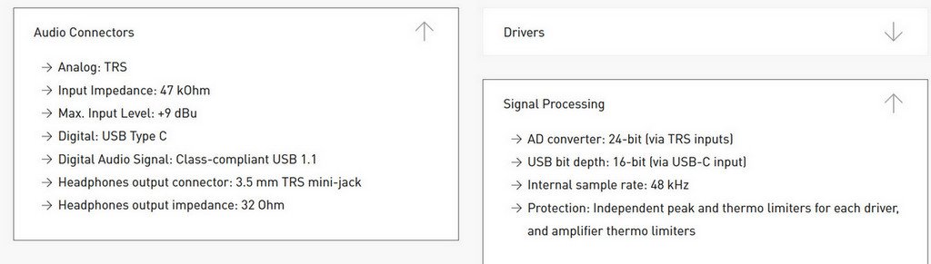

my question is will the Ultra be able to control the volume to USB 1.1 input? 16bit with USB / 48khz

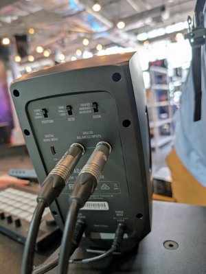

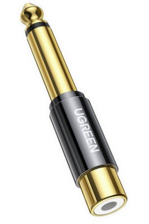

I can try the analog inputs, they are 1/4" TRS (Balanced?) not sure about converting to RCA.
