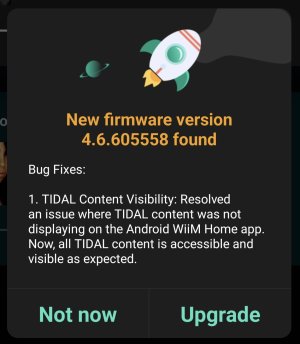

We have found the root cause and will release a new Android app today to fix this issue.

Hi, this issue only occurs with the WiiM Mini's latest firmware. We are sorry for the inconvenience caused!

Installed new firmware update and problem is solved, thanks for the quick and helpful solution... WIIM RULZ
