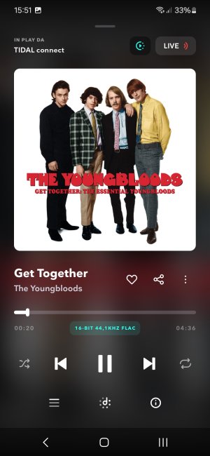

Maybe I mangled some words but the situation is that all files previously displayed as MQA by Tidal app, are now displayed as FLAC, in the way all people expected.
But, if you play those files on a MQA enabled dac, like a Bluos one, that dac anyway recognize they are MQA and activate such decoding.
Two images, one from tidal, the other from Bluos on the same playing.
Tidal says it's 44.1KHz 16bit flac, Bluos in the same time says is MQA studio master approved.
Meanwhile WiiM stopped at all to recognize it as MQA.
This could make thinking they didn't changed the files, just a flag...

Wiim recognize it as flac either playing it to app or tidal connect. Try to reboot bluos and see if there’s a change if not it probably need an update.
Maybe I have to be more clear...
Tidal connect app and WiiM app behavior, is now what is expected: no more MQA's reported.
Bluos app, can display whatever is playing even if started from other app, like Tidal connect, in the same way WiiM app can do. If the file played from tidal connect is 192khz, Bluos reports it as 192khz.
Instead, if I play an ex MQA, using Tidal connect to Bluos or even using WiiM toslink connected to Bluos MQA capable dac, both from tidal app or WiiM app itself, once those files reach Bluos dac, they are anyway recognized as MQA, even if Tidal and WiiM don't say that.
This can only means that files have not been replaced...
