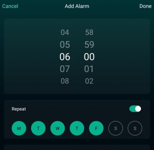

Is your alarm set like this?
If this doesn't work for you, you might want to set a separate alarm for each day of the week.

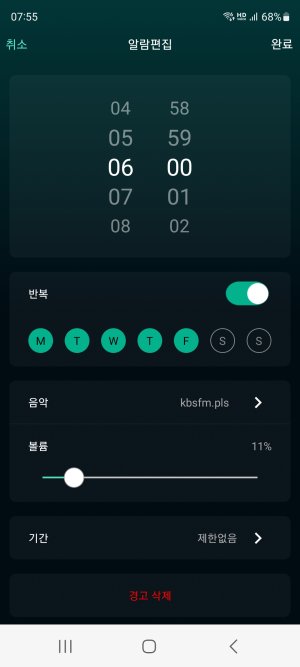

The description of the alarm anomaly was inaccurate
As shown in the picture, I set the alarm to not work on Saturdays and Sundays, but the alarm works on Saturdays
It seems to be a program error

The description of the alarm anomaly was inaccurate.
As shown in the picture, I set the alarm for all days except Saturday and Sunday, but the alarm rings on Saturday.

On Monday, Tuesday, Wednesday, Thursday, and Friday, the alarm goes off at 6am normally, so I can wake up early.
However, on Saturday, when I didn't set an alarm, the alarm goes off at 6am.
Please refer to the photos of the days I set.

On Mondays, Tuesdays, Wednesdays, Thursdays, and Fridays, the alarm is normally activated at 6 o'clock, so you can wake up early
But the alarm goes off even on Saturday when the alarm is not set
Please refer to the picture I set up
