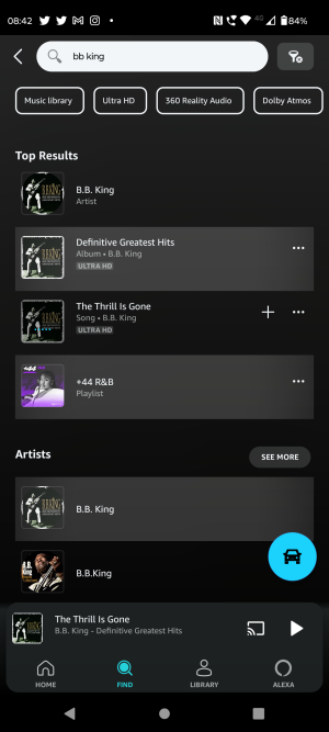

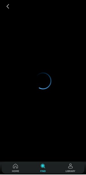

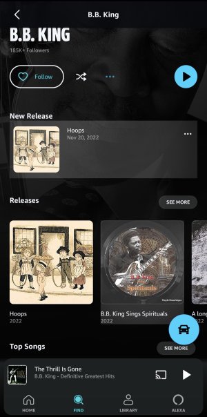

Unfortunately amazon has a bug for some time now: find option in android app doesnt work at all. They confirmed that issue but do nothing with that. Also there is a limit of playlists in wiim home and amazon will not allow to load more than 100. This is main issue for me as it is the only way to add complete albums to favorites in amazon.
Still don’t see an issue…
