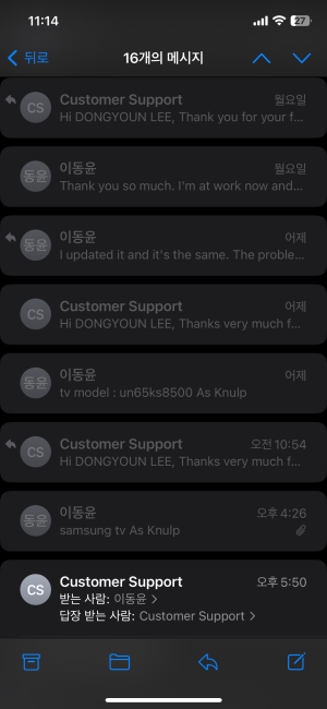

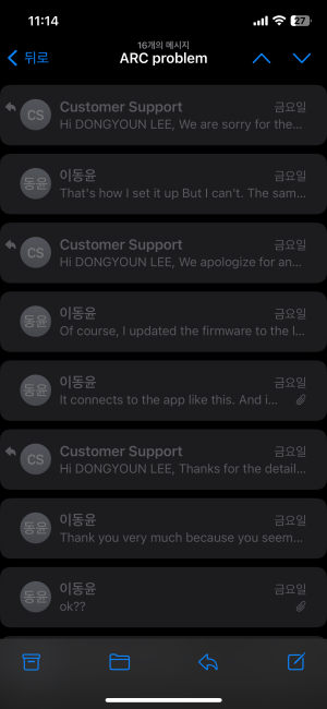

The unlucky arc problem is really annoying. It's just the tv sound, all the other amp soundbars are normal. No wiim amp only. It's really annoying. There's definitely something wrong with wiim amp. I'm sure!!!
I borrowed another machine for a few days and tested it. Just like my other machine, only wiim is the problem, but all other machines are fine. Many users in Korea are experiencing the same problem, but it's not being solved! I want to throw it in the trash can
Have you explained what the issue is in a ticket to WiiM so they can analyse your device log and perhaps make a suggestion as to how to resolve the matter?

I haven't been able to fix it for over a week. I recently said that firmware updates are a solution, but they haven't.
I'll wait one more day and if it doesn't work, I'll just give up and not use it. I don't think I can solve it. It's just stressful.
