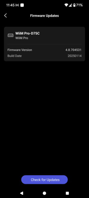

I am sure there have been firmware updates since January 14, 2025. Any idea as to why I get this when checking for updates? Should I do a complete factory reset?
Looks like a beta test version.
Try to install the DLNA beta test and then opt out of it again. Then you should get latest version.
And to do so, don't use the Firmware Update page on the More... tab but open the device settings and tap on Device Info.
You should see a big button Join Beta Testing close to the bottom of the page. In case no beta firmware version is shown as available, tap on More... => Feedback and let WiiM support know about the issue.
Thanks, solved.
