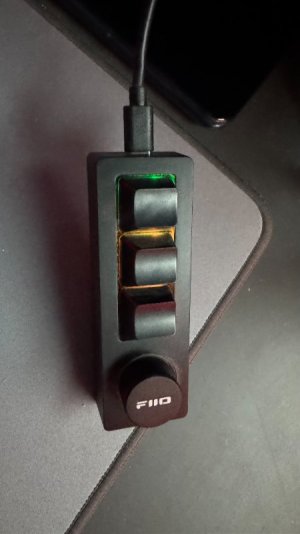

Many thanks for this gem of an app, just what I needed, as I had a couple FiiO USB knob/buttons waiting for such an app !

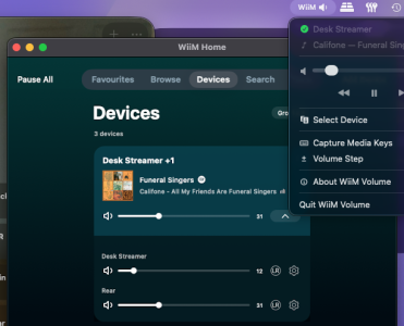

Seems to still be adjusting just the master, also thanks for the work appreciated.
See screenshot these are two WiiM Pro in action.

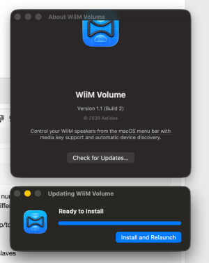

  • Fixed: Auto update didn't work, i made a mistake with the build versions and patch numbering. xD
  • Fixed: JSON parsing of the multiroom:getSlaveList API response (Wiim did things differently, or i had old docs)
  • Fixed: App now fetches current volumes before adjusting
  • Fixed: Correctly calculates delta (even) when volumes were changed by another app/touch buttons etc.

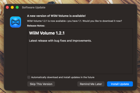

Updated to latest, I assume it wasn't meant to resolve the group volume issue?
Correct, im still working on the group function. it's more complex than 1 device. will release it soon :)

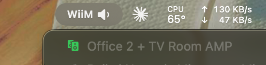

Tried your app today. It doesn't appear on my menu bar. It's running (showing up in activity monitor) but not visible.
that is strange. what does happen to me sometimes: the icon is hidden in the camera pill nudge (on laptops). can you share a screenshot of the menubar? also which OS version are you running? let's debug this :)
it's not going to be in your Dock with the icons. just menubar only. PS: when holding command, you can rearrange the icons.

picked up the latest version. Hard to do a screenshot of the missing icon as it's ... missing? :) running macos 26.2
Ha fair point 😄
Hmm, it's possible the app is starting but hanging before the menu bar icon appears. Could you check two things for me?
  1. Console.app — open it, filter by "WiiM" in the search bar, then launch the app. See if any errors or crash logs show up.
  2. Activity Monitor — when it's "running", does it show significant CPU usage? (that would suggest it's hanging/spinning somewhere)
  3. Keys -- do the volume keys repond? or nothing happens?
That'll help me narrow down whether it's a display issue (icon hidden behind the notch) or a startup issue. I'll also add proper logging in the next build to make this easier to diagnose. 1.3.0
Tried again and this time it shows up. I think the problem is that it behaves weirdly with menu bar manager. I'm using ICE (similar to bartender) and for some reason I can't make it visible.
