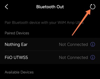

I also have an issue with Audio Out/Bluetooth. I set my Bose Headphones to pairing mode and it doesn't show up on the WiiM.
In my experience, sometimes the headphones don't show up on first pairing.
Have you tried pressing the refresh button in the top right corner of the Bluetooth output screen in the WiiM app several times?
Also, if the headphone is already paired with other devices, please unpair them all; turn off Bluetooth on all devices except the WiiM and then try pairing with the WiiM again.
