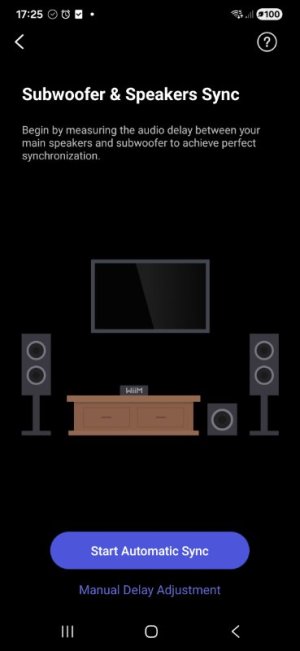

Addendum 4 - Extending "Auto-Sync" to Bluetooth & USB Digital Outputs
To make the Hybrid 2.1 or 4.1 setup truly user-friendly, the existing 'Syncing Subwoofer & Speakers' calibration tool must be extended to include all digital outputs.
The Request: Please enable the microphone-based Auto-Sync (acoustic measurement) specifically for Bluetooth and USB Audio modes.
Why: Bluetooth latency is the "elephant in the room" for hybrid setups. While enthusiasts can calculate offsets manually, the average user cannot. Since WiiM already has a proven acoustic measurement algorithm, applying it to the Bluetooth/USB chain would allow the system to automatically delay the wired Subwoofer (RCA) to match the wireless latency of the speakers.
The Goal: This ensures that the wired subwoofer and the Bluetooth/USB speakers are perfectly time-aligned and in-phase. It removes the "echo effect" and "bass cancellation" typically associated with mixing wired and wireless hardware, making the Hybrid 2.1 experience easy plug-and-play.
