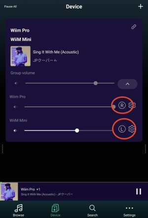

Connect two WiiM devices to their respective Echo Studios with optical digital cables and set up linkplay multi-room music for stereo playback. I can't think of any other way. However, I don't know if there is any benefit to doing it..

In the case of the aforementioned suggestion, after pairing the two WiiMs with Linkplay MRM, And you can output is divided between L and R like this.
You are absolutely right, thanks that could work but using 2 WiiM devices was not my preferred solution.
